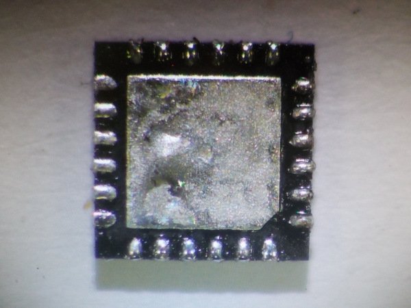

These chips are quite small, only about 4mm x 4mm, they have 24 pins (six along each side), and for added fun there is a larger pad in the middle of the chip which is used for a mixture of shielding and also cooling the IC.
The above photo is of the underside of the removed faulty 6965A, you can clearly see the large shielding/cooling pad in the middle. Don't forget that this whole thing is only 4mm across!

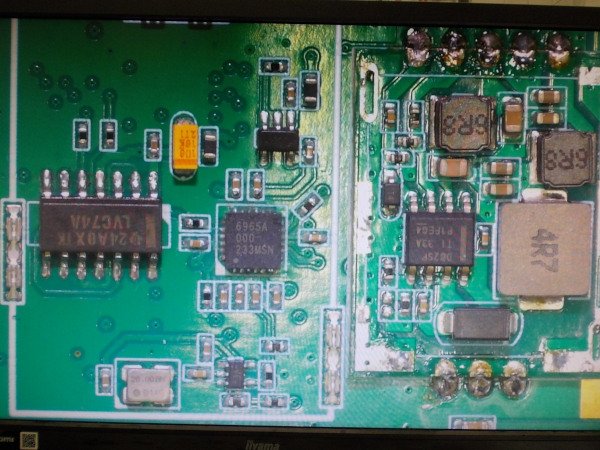

I also took a photograph of the PCB with the chip removed (see below). I placed the tip of one of my Fluke multimeter probes next to the pads to give some idea of the scale.

The above photograph shows the chip after replacement (the small square just above the middle of the view). Also visible is the PSU module mentioned earlier. There is a row of five connections on the edge furthest away from the camera, and it is on the leftmost pin that the clock pulse should be found. It's something like 3.3V p-p (on an oscilloscope), while on a multimeter it shows up as a steady 1.6V DC (this is the average). When the rig is not working this voltage jumps around all over the place.

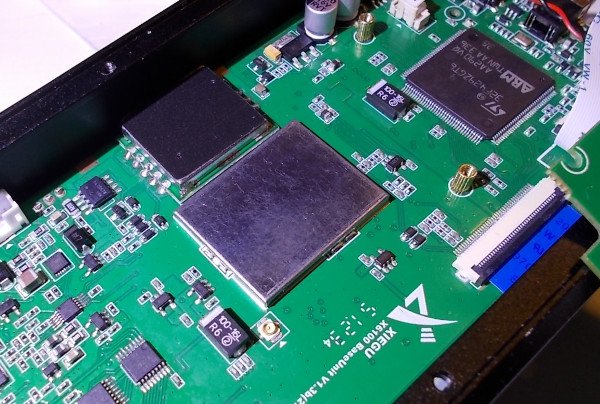

Here's another view after I had refitted the shields on to the PSU and also on to the clock generator section.
