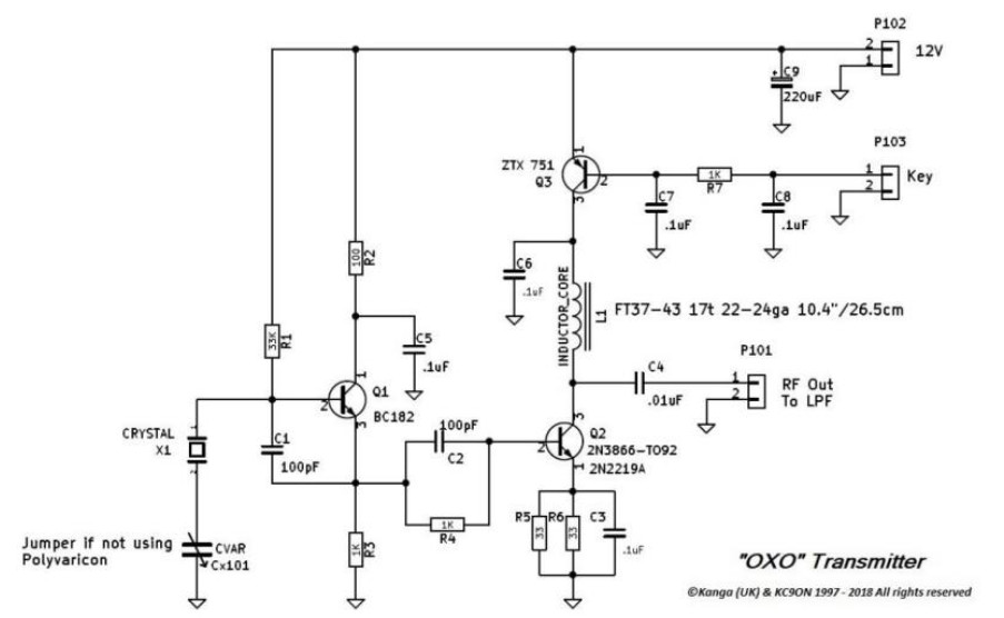

Ah, the 'venerable' OXO transmitter. I first came across the design in the G-QRP Circuit Handbook, published by the G-QRP Club in the UK. For those who are not familiar with the design it was created by George GM3OXX [sk] many years ago. There's a fascinating biography about George on the Lothians Radio Society website, you can read the article here: https://www.lothiansradiosociety.com/2017/10/10/silent-key-george-burt-gm3oxx-20-september-2017/
Here's the circuit diagram (from the Kanga version) of the OXO transmitter (click image to enlarge):
In your multi-band version, can you trim the crystal frequencies or are they essentially preset (determined by the fixed values of the components in the OXO)?
Also, how do you implement the receive side of the system? Do you run a receiver with its own independent antenna or does it share the transmit antenna via some kind of changeover mechanism?
73, Mark...

Ah, the 'venerable' OXO transmitter. I first came across the design in the G-QRP Handbook, published by the G-QRP Club in the UK. For those who are not familiar with the design it was created by George GM3OXX [sk] many years ago. There's a fascinating biography about George on the Lothians Radio Society website, you can read the article here: https://www.lothiansradiosociety.com/2017/10/10/silent-key-george-burt-gm3oxx-20-september-2017/
73, Mark...
No, Mark, didn't add the capacitor to tune around the crystal frequency. I keep changing things on it so that may come next. I was trying for the smallest package I could for this try.
And the antenna switch is just clipping a lead from the receiver onto the antenna when receiving and disconnecting during transmit. High tech! I also have to remove power from the transmitter because the oscillator is running all the time.
