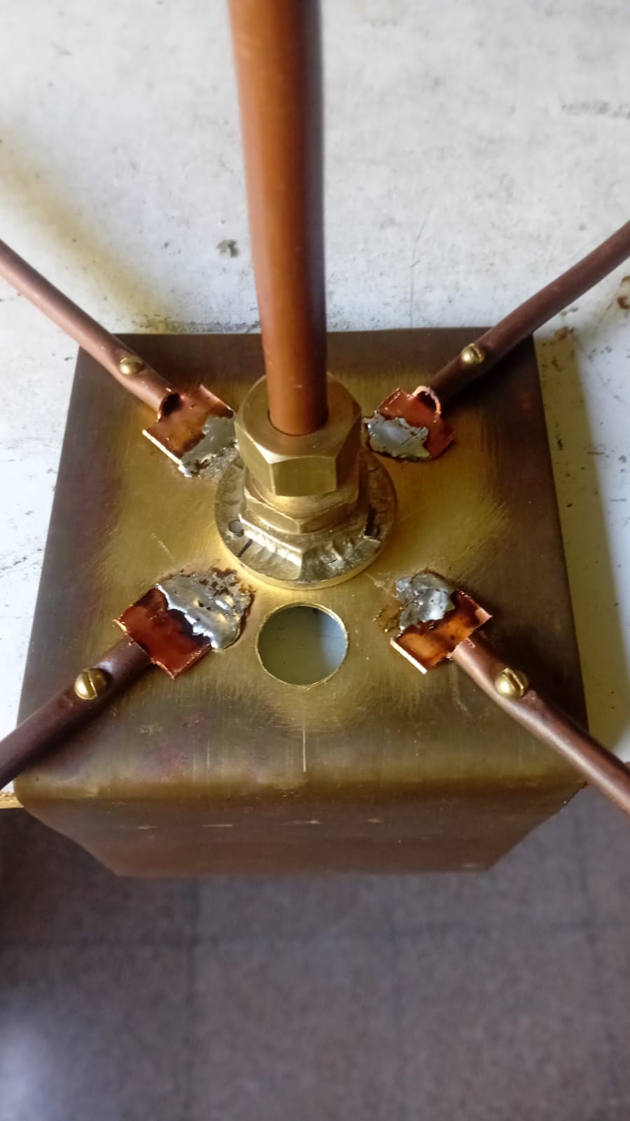

The project is becaming viewable.

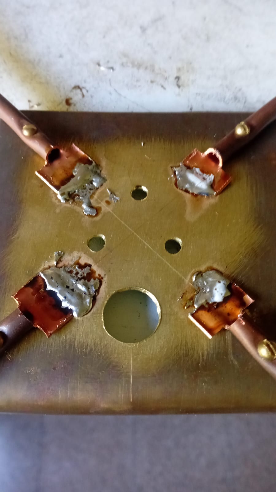

Tomorrow, using a 200W giant solder iron, a good soldering to insure good conductivity. 1/8" brass screw are for mechanical mount, only.
Here is the process of soldering the 4 rods composing the ground plane:

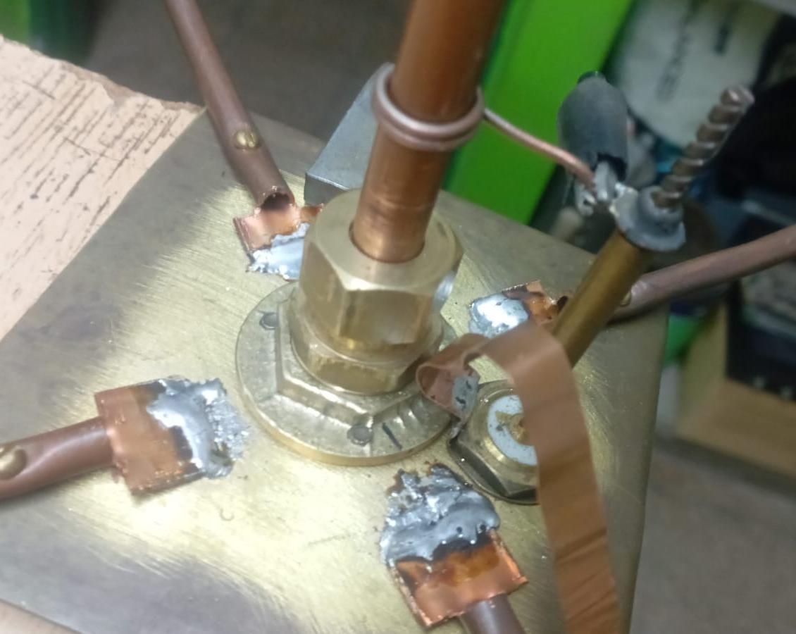

It still remains to complete the coupling loop. I designed the mounting in such a form that, if it doesn't work, I can return to the classic Gamma Match.

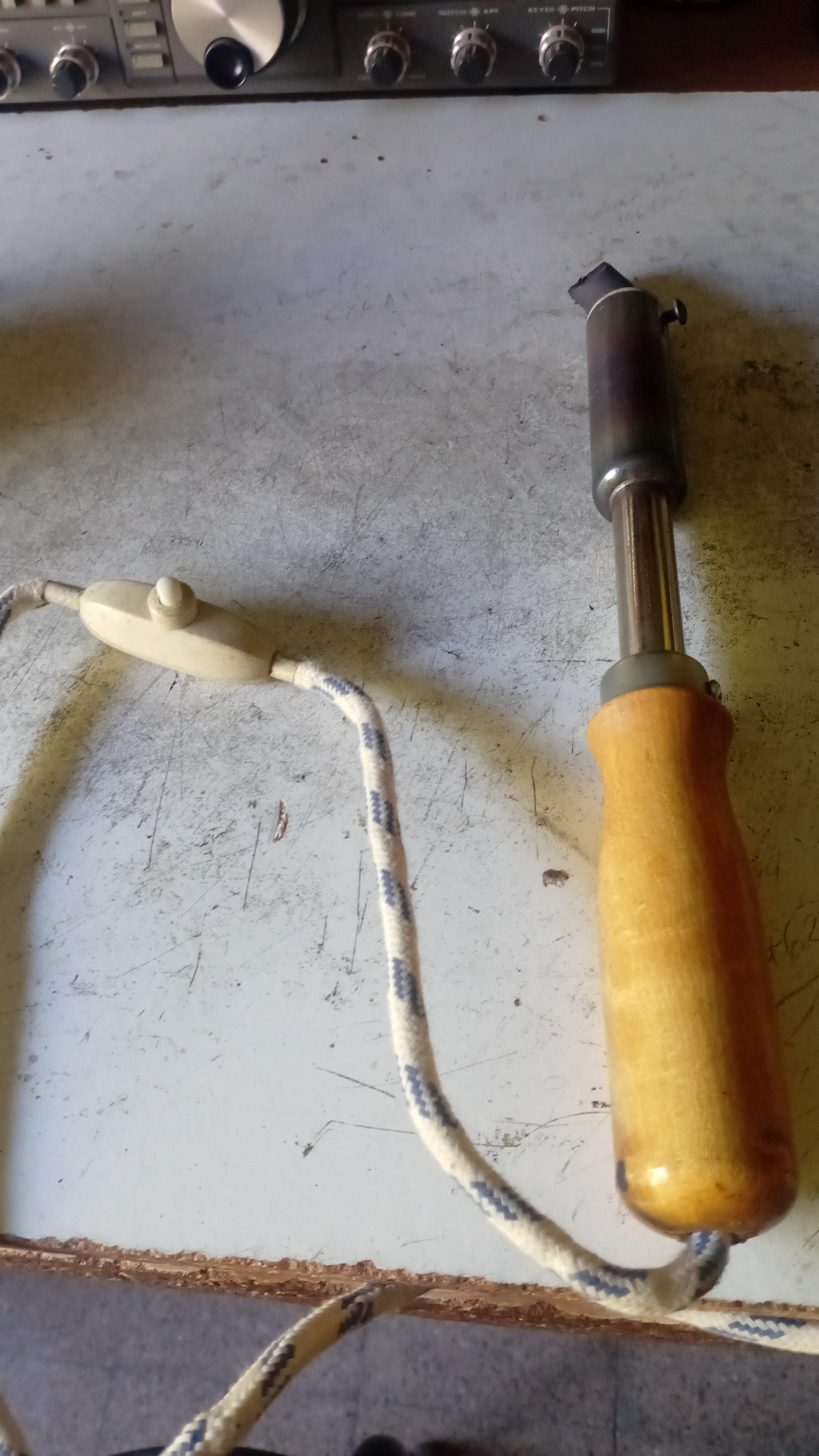

The 200W heavy solder iron, made in China, but plastic wire replaced with another impossible to melt. A switch added for more comfortable opeation.
Back
Top
