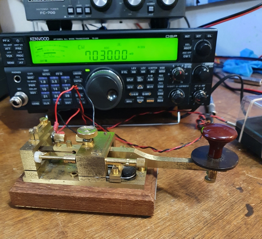

I dislike noisy straight keys too.  The keys with the contact on a string leaf like my HK802 is very quiet in fact it is a delight to use. I suspect that all the swedish pattern keys may be  quiet. The Czech bakelite bodied key that appeared on Ebay a while back is also nice and quiet too. My least favourite in my Kent whose wooden base seems to amplify the clatter like a guitar sound board.
Just my 2 penniies worth
Alan G0KMC

I used to own a Hi-Mound HK802 many moons ago. I sold mine for a couple of reasons, one being that I liked the feel of the key when the control 'button' was adjust quite a way back, which meant there was always a long section of arm sticking out and looking awkward. Also, I would have like a thumb rest disc which I've never seen on these keys (though there is a brass ring under the button, but it's a bit small in diameter for my tastes).
When adjusted to the front of the arm the key feels very much like the Swedish pump key you mentioned. Another key with a similar feel (though very much cheaper to buy!) is the Polish "Stork" Key.
Up the top end of the cost scale are thing like the Marconi PS-213 keys (and the AS-300 labelled ones).
73, Mark...

I bought my KH802 back in 1992 after trying a few others including a Swedish key and I remember that the guy at South Midlands Communications at Chandlers Ford (remember them) was very patient as I spent nearly two hours trying keys out. I settled on the '802, It was expensive at 100 pounds but worth it. I still have the original box etc kept safe.
Pic attached and as you will notice I have added a thumb rest.
73 Alan
